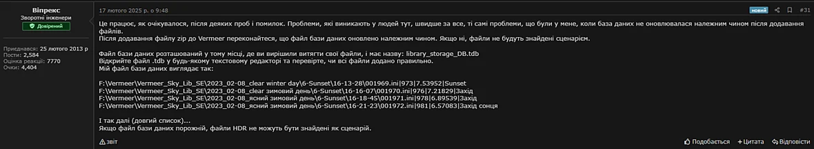

на персии такое решение есть, оно же тут выше написано скриншотом
Probably the best Hdri currently available.The height of the horizon can be easily managed with the plugin.And the plugin has some great options!Choosing the time for an hdri is amazing!But for me the plugin does not install the packages correctly.I had to manually move the folders....\VERMEER_Library\Vermeer_Sky_Lib_SE\BLUE-HOUR-001_DAWN\2022_11-02_clear autum\1-Dawn\06-21-14...To...\VERMEER_Library\Vermeer_Sky_Lib_SE\2022_11-02_clear autum\1-Dawn\06-21-14...For each package.And the problem is solved
